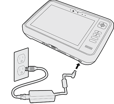

It takes approximately 6 hours to charge the T7 tablet / Yuma 7 tablet computerbatteries from an empty state. It may take longer if you are using your device for power-intensive activities, for example using GNSS or processing a lot of data while you are charging it.
Charging the batteries in the device
  1. Connect the appropriate international plug adapter for your region to the AC adapter.
  2. Connect the power cord to the charging port on the device.
  3. Plug the power supply into an electrical outlet.
